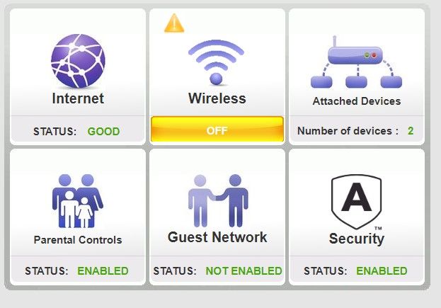

- BiggFreddNov 28, 2022Aspirant
This is what's showing
- FURRYe38Nov 28, 2022Guru - Experienced User
Check this, under Advanced Tab/Advanced Settings/Wireless Settings, is both radios enabled and have a check mark next to Enable SSID Broadcast?
