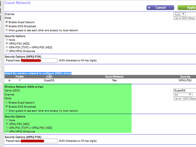

d7000 guest network defaulting to 5g
hi
im new so please dont bite.
ive a d7000 and have had issues where i connect to my 2.4 ssid and end up (showing at least) on the 5GHZ. RESOLVED by updating firmware to V1.0.1.66_1.0.1

sitomkins
Dec 31, 2018Aspirant
Im using the ring software to connect, Ring is a company owned by Amazon and the doorbells are quite well known here in the UK
During the install procedure the ring software only shows me the 2.4ghz networks. Im selecting the 2.4ghz network and ring is stating that its connecting to them.
Its only after that connection is made that its going to the 5g network, which has a seperate SSID and a different password to connect.
Until i updated the firmware yesterday i had the same issue on the non guest networks. where in the 2.4 ghz networks were being ignored.

- sitomkinsDec 31, 2018Aspirant
Hey thanks again for replying, and no problems im sure ill work it out. For the record though..The 5ghz network these things are being connected to is disabled (see below). Thats what i dont understand about this.

- sitomkinsJan 02, 2019Aspirant
turns out this is simply a screen problem - its displaying the wrong SSID on the netgear admin connected devices screen.
