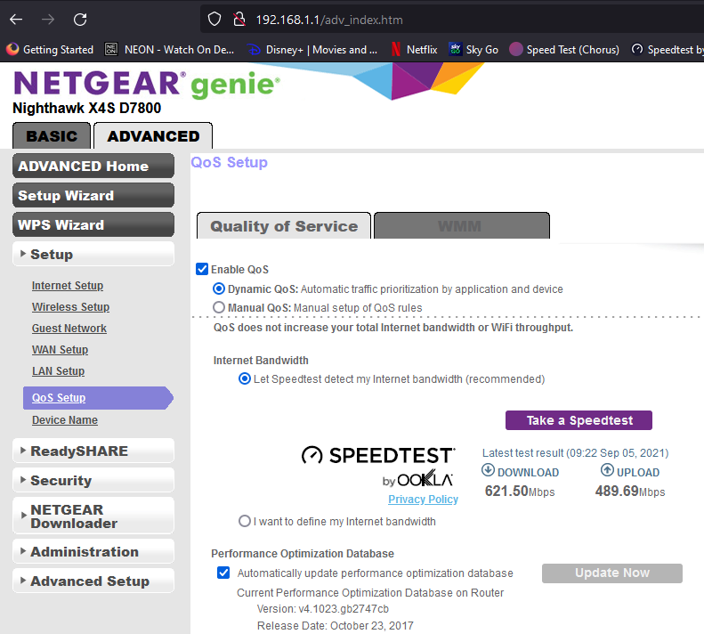

The thing that makes it more confusing is that when I log into the router and complete a speedtest from there I get a download speed of around 550Mbps. So it seems like the router is receiving a high speed connection but then on the 'output' side the speed is dropping significantly.

4) With regards to the 550Mbps comments , I found that in the D7800 router config, the QoS setup under the Advanced tab of the Router (accessing via 192.168.1.1), I can run a speed test from within the Router itself (apologies for my lack of technicial explanation here!) I have included a screenshot below if this helps explain - this particular example actually shows a faster download speed of 621.50 Mbps.
However if I run a similar speedtest using URL https://www.speedtest.net and using my laptop plugged in with a Cat5e cable directly into the router and then I will only get a speed of 150-150Mbps.
In terms of the physical setup I have the ONT and then a Cat5e cable from the ONT into the D7800. Then a Cat5e cable from the D7800 to my laptop.
To me is seems like the Router is somehow limiting the speed? Could this even be possible?
