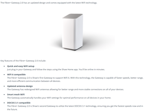

jad12
Sep 26, 2022Aspirant
Ok. I will try the suggested approach and see what happens.
Current router is Nighthawk AC1900 Smart Wifi Router (R7000).
Switch is D-Link.
The new modem setup arrives on Wednesday. It appears to be Gateway 2.0
- plemansSep 26, 2022Guru - Experienced Userfrom your specs, it appears to be a modem/router combo device. It'll cause a double nat in default mode. A double nat happens when you cascade more than 1 router.
 https://kb.netgear.com/30186/What-is-Double-NAT
 Fixes? There’s 3 options but only use 1.
 1. Put the modem/gateway in modem only/pass through mode. This disables its routing functions.
 2. Leave the modem/gateway in router mode but put the Netgears IP address into its DMZ. This forwards the data to the netgear. You can either leave the modem/gateway’s wireless enabled or disabled. Just make sure its using a different wifi channel to prevent interference
 3. Put the Netgear into access point mode. This disables its routing functions. Wifi/ethernet still works but it does disable some features.
 https://kb.netgear.com/26765/Which-features-are-disabled-on-my-NETGEAR-router-when-it-is-set-to-AP-Mode- jad12Sep 26, 2022AspirantThank you. I vaguely recall that I had to set the modem to pass through mode before (~ 4 years ago). Right now all attached items are on the router none on the modem. - jad12Sep 27, 2022AspirantDoes anyone have any insight into which option would be best for the wifi signal. Will the new Gateway 2 modem provide a much better wifi signal than the Nighthawk router, or vice versa? Or they both going to be about the same?
