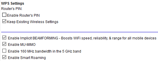

Disable WPS on R9000 Nighthawk X10 AD7200
I read this KB on the subject: https://kb.netgear.com/19824/How-do-NETGEAR-Home-routers-defend-WiFi-Protected-Setup-PIN-against-brute-force-vulnerability It says this: To disable the Rout...

> According to the R9000 User Manual, what you want would be at ADVANCED > Advanced Setup > Wireless Settings : Enable Router's PIN (or not).
Now we're back to square one. Problem is, the Enable Router's PIN checkbox does not exist on that page...a screenshot of that page was attached to one of my previous posts...attached here again (a fuller screenshot, as it includes everything on the left, too).
WPS Settings (disabled when smart connect is enabled)
What do we know about Smart Connect on this router?

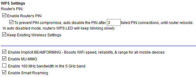

Good catch!
> it'd be under BASIC > Wireless
It is (but the manual has no mention of Smart Connect in that section...or, for that matter, anywhere in the manual).
> looking for a different firmware version
> In case you don't already know the way
As I mentioned in the initial post, I had already upgraded to the latest firmware (V1.0.5.24) before posting.
After un-checking Smart Connect, the WPS settings came to life. Attached two screenshots show the PIN enabled and disabled.
Thanks for catching the Smart Connect issue...much appreciated! Regards, Joe
Edit: Seems that you can't attach more than one file in this forum. I'll put both screenshots inline...hopefully, the Mods will be around to approve them.
