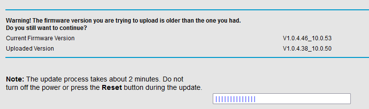

        I downgraded the firmware to the previous version, R7900-V1.0.4.38_10.0.50, which has solved the DNS issue on the Windows and Android devices.  However, the Circle vulnerability is not resolved to mark this as a solution.

  • I was running the lastest as well and assumed maybe Comcast was doing something crazy to force me into using their DNS but alas it was the firmware upgrade.  I was running a VPN and so I did not notice it at all unless I was not running my VPN.  I originally was running OpenDNS with filtering then tried Cloudflare and finally resorted to ISP to which at that point it was what lead me to an update issue.  Reverting back from V1.0.4.46_10.0.53 to V1.0.4.38_10.0.50 seems to have fixed everything.
