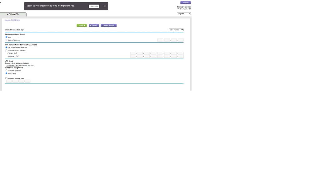

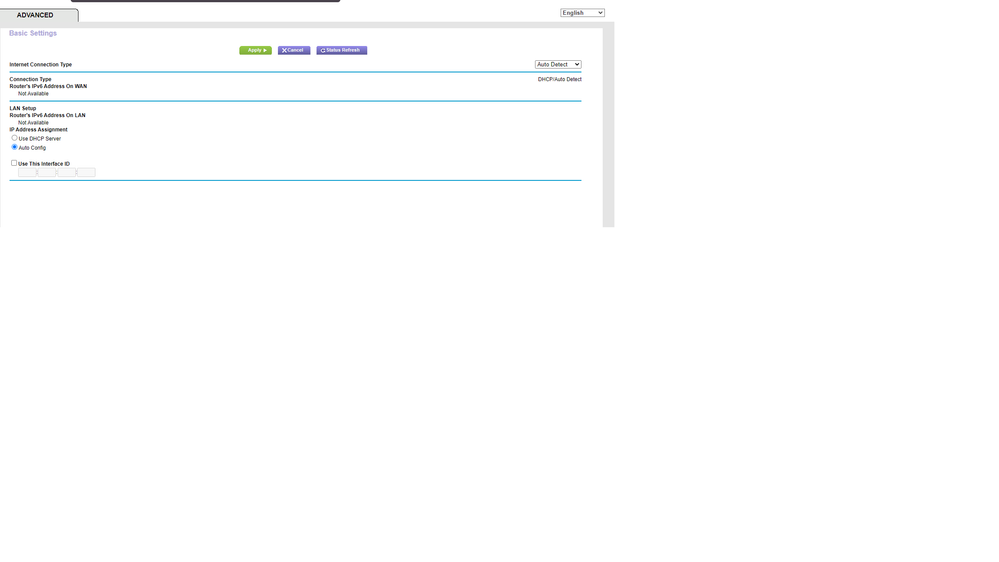

I tried with "Disabled" to "6to4Tunnel", work fine around 30min then appear again the message DNS_PROBE_FINISHED_NXDOMAIN, before this IPv6 enable the error occurs inmediately.
Now i tried with the IPv6 Automatic Option, i choose this option, after apply changes appear in 6to4 Tunel, is like the router not refresh this change or choose 6to4 like automatic?.
