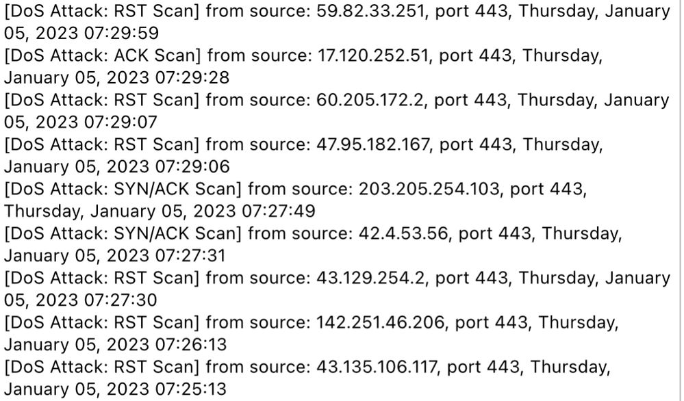

Hi, I've been getting these Dos attacks for a couple weeks...
I want to know if this is a fake report from the router or if there is a real DoS Attack...Every time it is accompanied by the network almost unusable.

    Would be helpful to what what NG router product your seeing this on.
    You can do a WHOIS lookup on those IP addresses to see where they come from as well.
    Be sure your using a good quality LAN cable between the modem and router. CAT6 is recommended.
    Most times the log is just reporting what the router is preventing or stopping...
    Has a power off for 1 minute then back ON with the ISP modem and router been performed since last update?

    if something is not replying on the IP stack, the Netgear known flawed "DoS attack" does tend to spill masses of such messages. Typical issues on flooded NAT sessions, not receiving expected answers in time, and often if the Internet connection uplink is segregated ... it's amazing how much theories are developed and pushed on this subject to these communities over the year. Gee, if an ISP or different service provider with this massive bandwidth available would DoS most users Internet connections would immediate lead to a interruption of your Internet services - faster than you can think of or figure out IP whois ownerships.
    last, then i shut up and stay silent on the subject: what is the point of submitting lists of suspect IP addresses in graphics format? 100% useless: We know the IP ownerships of virtually all services for suspect flawed attackers - virtually all are providing https services on port 443 8-)
    i wish Netgear would immediately go and disable this DoS attack junk, avoiding leading their customers mislead for things which are normal in daily network and IP operations.

    Netgear's firmware is great at creating false reports of DoS attacks. Many of them are no such thing.
    Search - NETGEAR Communities – DoS attacks
    Use Whois.net to see who is behind some of them and you may find that they are from places like Facebook, Google, even your ISP.
    Here is a useful tool for that task:
    IPNetInfo: Retrieve IP Address Information from WHOIS servers
    If these events are slowing down your router, that may be because it is using up processor time as it writes the events to your logs. Anything that uses processor power – event logging, QoS management, traffic metering – may cause slowdowns. Disable logging of DoS attacks and see if that reduces the problem. This does not prevent the router from protecting you from the outside world.
