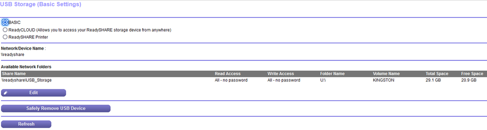

Just installed an AC2600 for the first time. Plugged a WORKING USB Flash disk into the router. USB light is off. Ensured that Network Neighbourhood is checked in USB Advanced Settings. But no disk, or even the router shows up in Windows explorer. All of this seems to indicate that the USB port is broken... but if I click on Create Network Folder, the webpage shows USB Device as U: Kingston and when I click on Browse, all the files and folders on the disk are shown. What am I doing wrong?
I have solved the issue.... there is no USB fault.... it has to do with Windows 10 functions... they must be changed to enable SMB file sharing support (Function Discovery Provider Host, Function Discovery Resource Publication Properties and Windows Feature SMB1.0/CIFS File Sharing Support). Here is the YouTube video that provided all the answers.
What is this USB drive? How is it formatted?
You don't say what is on the PC end, but I see "MacShare" in your hard ti read image. Does that mean a Mac?
I am happy to say that I know nothing about Macs. Windows sharing can need SMB tweaking to make files visible. (Nothing to do with ReadySHARE.) Maybe Mac has similar needs.

Standard formatting i.e. NFTS/FAT for Windows. Reference to MacShare came from the Netgear webpage. Computer attached to Router is Windows. I tried using several flash USB disks and they all work perfectly when plugged into the USB port of my Windows 10 computer. Per your suggestion, I will try other flash disks and this time I will reformat to FAT myself. Thanks for helping me.
That should be fine. Nothing exotic here.
Try this then.
Solved: ALL Netgear USB Drive Mapping Issues ReadyShareCo... - NETGEAR Communities
