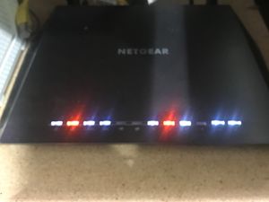

Firmware update failed, Ethernet port is not functional
Last night I attempted to update the firmware on the router. There was a problem with the update. Now I cannot connect to the internet as the ethernet ports are not functioning. I can con...
- Jul 29, 2021
I completed a factory reset earlier today. When I did that there was no change to the LEDs. Also connecting something to those ports does not change the status of the LEDs. I have come to the conclusion, it is a HW issue.
