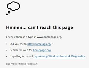

Firmware Version V1.0.4.120_10.0.91 for R6700v3 -- Slow connections and MS Outlook Sync errors
Hello! I allowed my R6700v3 (AC1750) router to install the latest firmware update (V1.0.4.120 10.0.91) a few days ago. Ever since then I've been experiencing slow connection to several web sites a...
