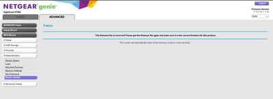

Flashed R8000 with R7000 firmware
Hello All,

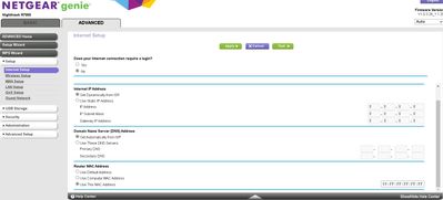

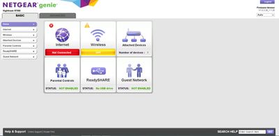

I have flashed the R8000 with R7000 firmware. I can login via 192.168.1.1 to the router's home screen (r7000) however every attempt at flashing a different firmware in the gui has failed.
I have tried factory reset in the gui, no go.
The mac address has changed as well to 00:FF:FF:FF:FF:FF. Tried changing it in the gui manually but that doesn't work.
I know nothing about routers, but after reading the forums on here I managed to get the below log file from putty.
I have already invested so much time in attempting to fix this router and would like to but I don't know how and more importantly if it can be salvage.
