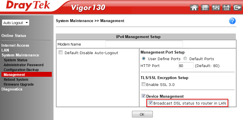

After further investigation, I seem to have fixed this problem.
My Router is connected to a Draytek Vigor 130 modem.
https://www.draytek.co.uk/support/guides/kb-vigor-130-dsl-status#modem-configuration
shows :-
The DrayTek Vigor 130 and Vigor 120v2 modems send DSL Information to the router by default.
The DSL information is sent as a UDP broadcast packet on port 4944. If this isn't required, it can be disabled from the [System Maintenance] > [Management] page of the modem's web interrface, by disabling the Broadcast DSL status to router option:
This happens every 10 seconds. For some reason the port is being reported as UNKNOW by the Netgear router.
If you untick the Device Management option (see below) then the fraggle attacks every 10 seconds stop.
