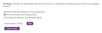

        This is something that you can do this on the page where you set the mode. But it may be hidden.
        Click the AP Mode icon and this should pop up:
        Ignore the "(not recommended)" warning.
        An alternative is to "Reserve" an IP address in your router's settings.
        Maybe Kitsap can suggest which is better. I've used both and don't notice much difference. The result is the same, an IP address that you don't have to hunt down.
