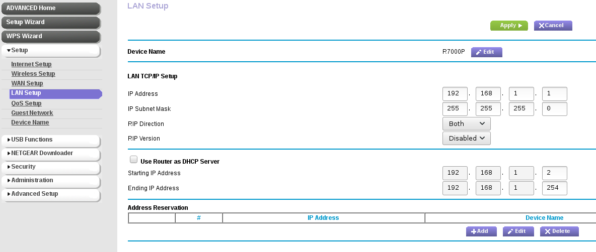

antinode
Oct 18, 2019Guru
> [...] "The IP address conflicts with the WAN IP subnet. Please enter a
> different IP address." [...]
That sounds as if it should be a complaint about the WAN address and
the LAN IP subnet. What do you see under ADVANCED > Setup > LAN Setup :
LAN TCP/IP Setup?
What were you expecting to use as a DHCP server after disabling the
one on the R7000P? How is that one configured? Is it already active on
your LAN?
If the router settings look reasonable, but the router complains in
unexpected ways, then I'd try a settings reset and manual configuration
of the router.
> Wan is served by a cable modem [...]
Not a very detailed description of that device. Maker? Model? Is
it a modem or a modem+router?
Badock
Oct 18, 2019Tutor
I've attached a small png showing the LAN TCP/IP Setup. It's in no way interfering with the WAN IP. From here, I hit Apply and the error message pops up. Reload the page and the DHCP Server shows as being selected again.
I'm running Pi-hole on a Raspberry Pi 4B on the internal network. It has a DHCP Server that is currently disabled. Once I get the router's DHCP server off, I can enable the Pi-hole's DHCP server with a mouse click. It's currently serving as the DNS server for the Lan with no problems.
I've been trying to get this going for a few days now. Tonight, before my first post, I hard reset the router and reinstalled the firmware with the Update utility. So there should be no leftover config. It didn't help.
Cable modem is a Arris Surfboard SB6141, pure modem, not a router.
Wan IP is 66.51.xxx.xxx and Lan IP is 192.168.1.1 (the default) so I really don't understand what's going on.
