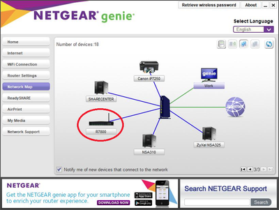

    When I want to access an AP, I se the desktop genie for Windows. (A Mac version is also available.)
    You can also manage "Guest" and some other settings with the desktop "app" for your operating system. This can be quicker and easier than diving into the browser graphical user interface (GUI).
    Netgear is trying to kill this useful utility, but for the time being you can find it here:
    genie | Product | Support | NETGEAR
    Be warned that the genie installation file is wrapped up in a RAR archive that you have to decompress.
    A good thing about the genie is that it provides a network map that can show the IP address of the AP as a clickable link.
