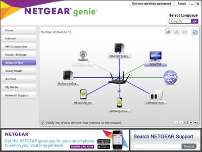

A useful tool when trying to analyse a network is Netgear's hidden desktop genie, especially its network map.
Click a device in that map at it reveals more details. It can even throw up a clickable link for devices that have their own GUI.
Netgear is trying to kill this useful utility, but for the time being you can find it here:
genie | Product | Support | NETGEAR
Be warned that the genie installation file is wrapped up in a RAR archive that you have to decompress. It still works in Windows 11. No idea about Macs/
