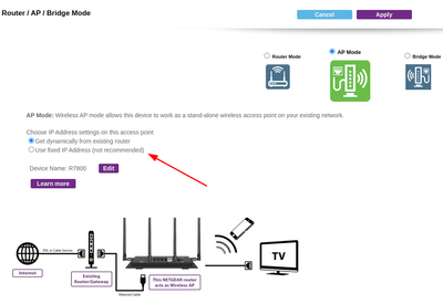

Look in the settings.
- Settings
- Advanced setup
- Router / AP/ Bridge Mode
- AP Mode
- Use fixed IP Address (not recommended)
Take it away....
- thompsondcMay 15, 2023Tutor
Thanks. I did that. Although it says that method is NOT recommended:
