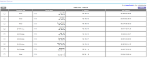

Machine not seen on peer to peer home network?
 Model R7300DST (AC 1900)     4 computers:  3 laptops Win10 (Lenovo T61 Pro, P50 Pro, Dell Home)  1 desktop Win7Home     Problem: The T61 doesn't see anyone and no one sees the T61     Diagnostics:  1...
- Aug 06, 2017Resolved. I even hate to admit it but the T61 (my old laptop before my current) was still plugged into the CL modem that is bridged to the Nighthawk. I plugged it in to the router and now the T61 sees all and is seen by all. Thanks, Mark

> 1. Router Connected Devices sees IP 198.168.1.6
   What's the IP address of the router (LAN interface)?  (ADVANCED)
> 2. IP config /all issued on the T61 sees IPv4 192.168.0.10
   198.168.1.x and 192.168.0.x are (normally) different subnets.
> 3. Advanced IP Scanner sees ...
   And what are those IP addresses?
> Suggestions?
   Make sure that all these computers have Local Area Connection Status
> Local Area Connection Properties > Internet Protocol Version 4
(TCP/IPv4) Properties thing says "Obtain an IP address automatically"?
- Markg2Aug 06, 2017Tutor1. I'm attaching a screenshot of what I believe to be the LAN IP. 2. If problem don't know what to do. 3. In my first post, the second screenshot, the 5 IP addresses associated with Wistron Corporation 4. YES Internet Protocol Version 4 (TCP/IPv4) is checked off. However, the Properties tab says zip about "Obtain an IP address automatically". Where are you seeing this? This is the what I'm looking at: - Markg2Aug 06, 2017TutorResolved. I even hate to admit it but the T61 (my old laptop before my current) was still plugged into the CL modem that is bridged to the Nighthawk. I plugged it in to the router and now the T61 sees all and is seen by all. Thanks, Mark
