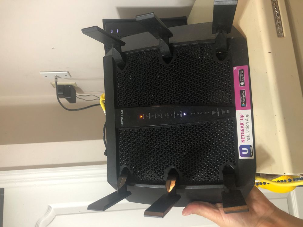

Backstory: I was updating to an older firmware for my R8000 from DD-WRT and it stopped out of nowhere mid update. Now when I turn on my R8000 it only has the power led light on (orange). All the other lights are off. The only other light that will turn on is the LAN Port lights if I plug in an ethernet cable into those ports. I tried plugging in my modem into the R8000 but there is no signal going into it. My modem's wifi works because I've plugged in multiple ethernet cables from the modem directly into my Laptop and Xbox and they all worked with wifi. I'm sure it's a firmware issue since it stopped mid update which resulted in the router to stop working properly.
My Router

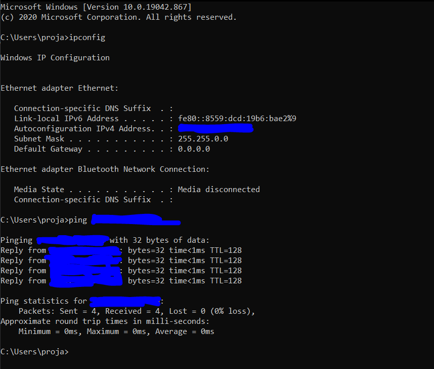

2. I connected my ethernet cable to my router in the first LAN port and the other end straight into my laptop. I wanted to ping the rotuer to see the routers IP and to see if it gives me any signals back. I found my routers IP and I covered it in blue, here are the results of this test. Then I made a static IP for router.
Ping With My Router's IP

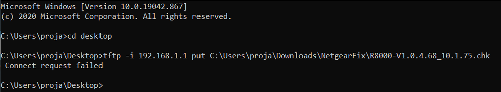

3. I tried to upload the R8000 firmware to my Netgear router using Windows TFTP. I followed the instructions listed here (https://kb.netgear.com/000059634/How-to-upload-firmware-to-a-NETGEAR-router-using-Windows-TFTP). Here are my results below.

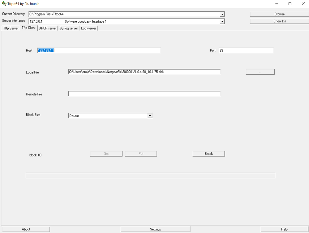

4. Next I tried to use Tftpdd64 and followed the instructions listed here (https://kb.netgear.com/000059633/How-to-upload-firmware-to-a-NETGEAR-router-using-TFTP-client). I ended up receiving a "block #0" which was another fail. I tried changing the host name from 192.168.1.1 to 192.168.1.10 but it resulted in a fail as well.
