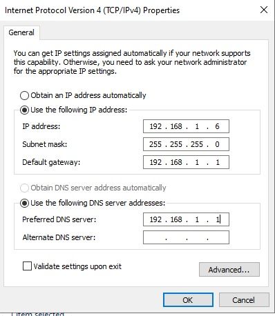

> Static ip [address] set on pc (192.168.1.6)
How, exactly?
Terminology: A "static" address is configured on the device itself.
What you configure on a (DHCP server on a) router is a reserved dynamic
address, not a static address. Either one should fix the address of a
device, but some implications are different.

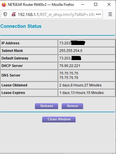

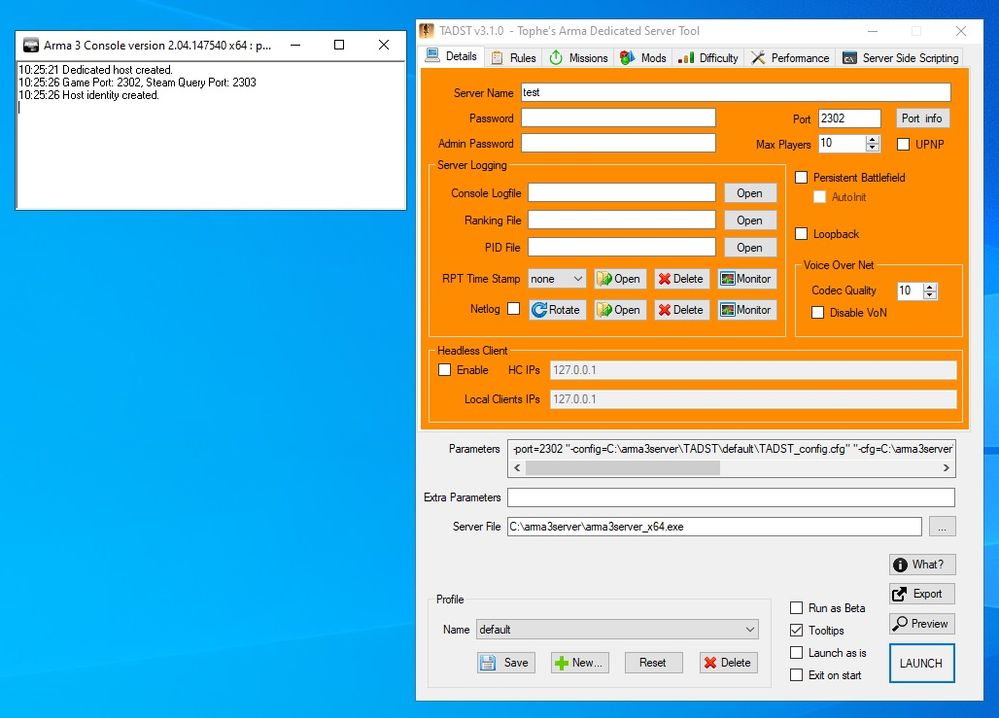

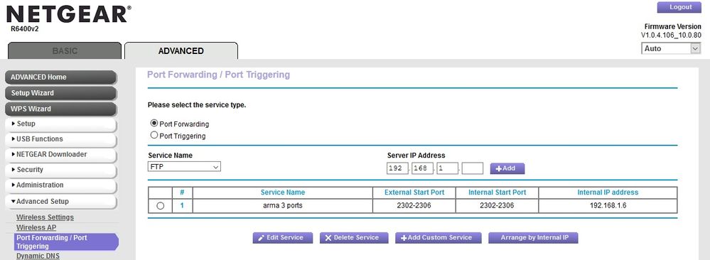

ty for the reply. so its a netgear r6400v2 router.
ipv4 is set in windows as you see in the pics.

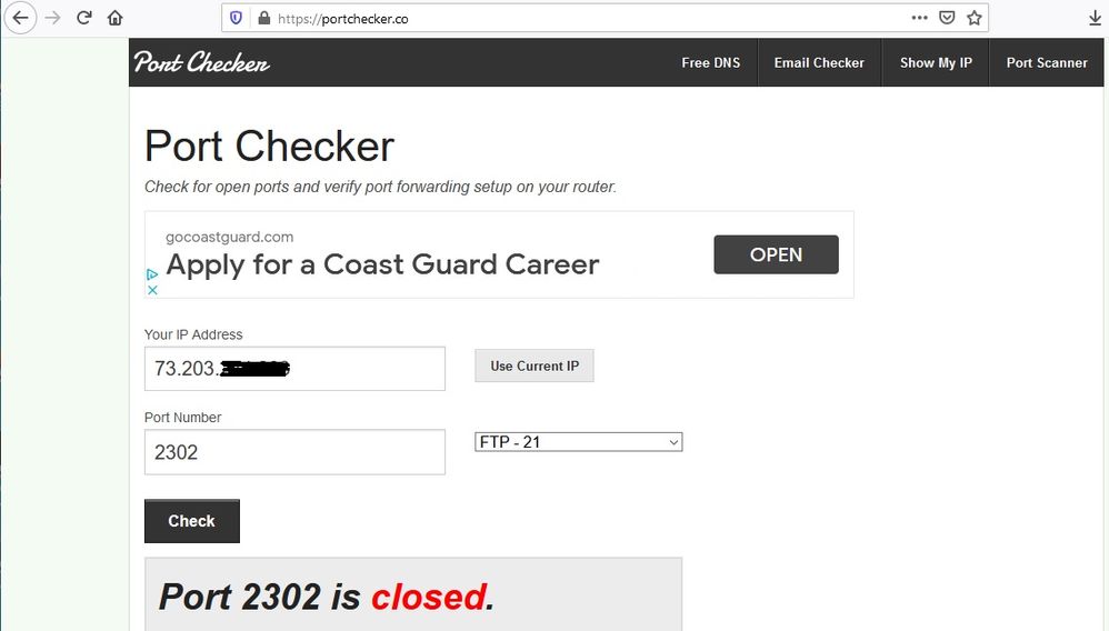

tested ports with portchecker.co and canyouseeme.org. both show port is closed.
here are some pictures of everything i have set.
