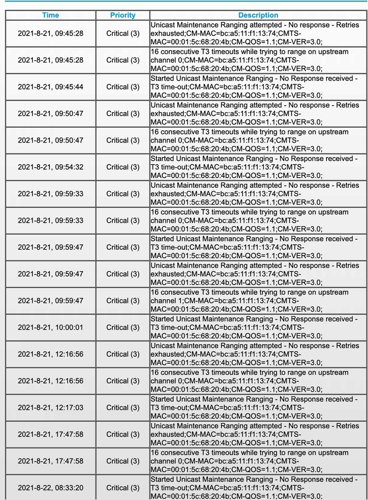

Netgear C7000v2 Upstream Light Blinks Randomly (No Internet)
Recently, my NETGEAR AC1900 Model c7000v2 has been acting up. The internet will go out randomly throughout the day and the upstream light blinks. Everytime the internet goes out, the upstream light b...

do you have a screen snip of the cable connections page and the event logs?
that helps us check the signal.

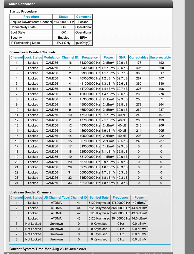

- plemansAug 23, 2021Guru - Experienced User

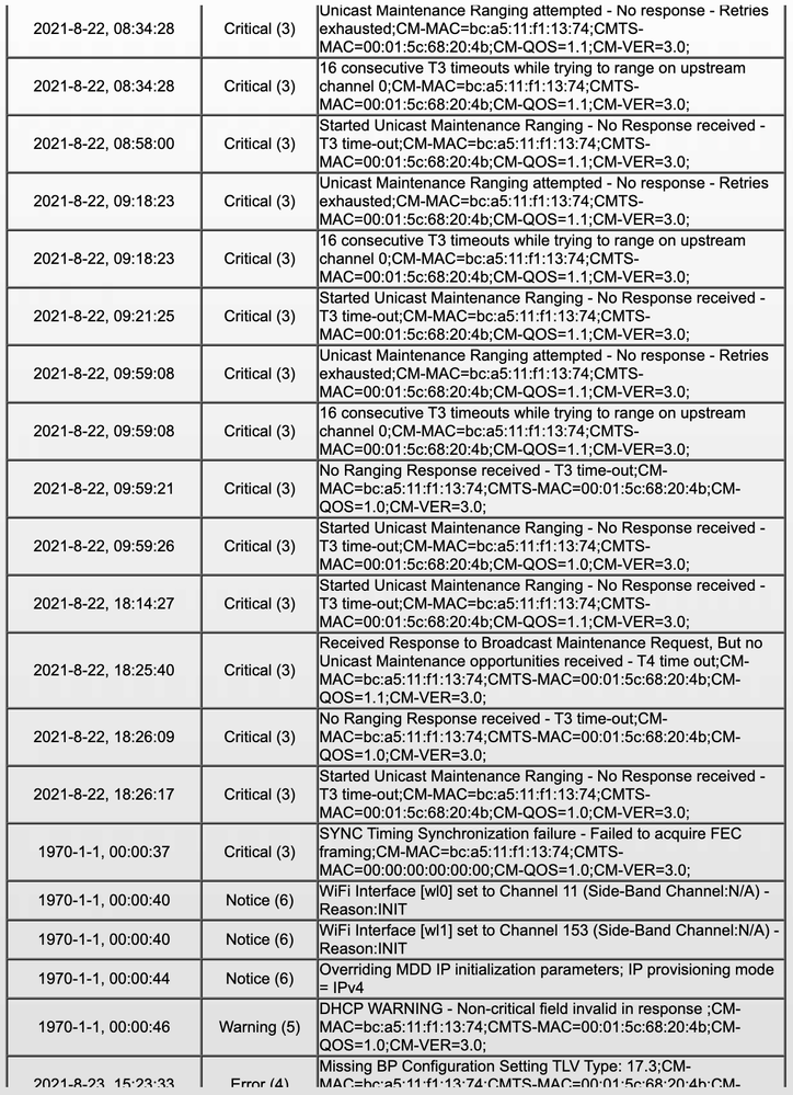

Your logs are indicating line issues.
Do you have the cable connections page the shows snr/downstream/upstream values?
