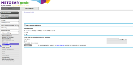

Hi Guys, Networking noobie here. I am trying to enable my VPN service for my laptop and my phones but I see here that the service is grayed out.. Would you guys know what I can do to enable ...

If it's in AP mode, try setting it back to router mode, disable DHCP and any WAN stuff (if required) plug into a LAN port instead of the WAN and re-try. It will still be in router mode but acting as an AP...Make sure you give it an IP address so that it can be managed..

Thanks! I've set to Router mode and the VPN Service was enabled afterwards!
