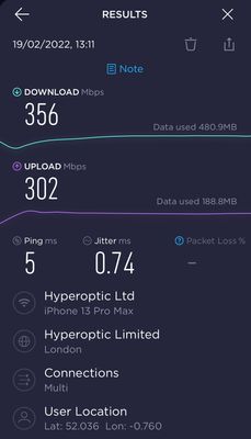

Netgear Nighthawk X6 R8000 - Cannot get more than 100Mbps speed when connected to ISP router/modem!
Hi all, I have Hyperoptic Fiber Broadband - 1Gbps package and the most I am getting wired is 950Mbps and wirelssly (wifi 5) is between 300-350Mbps. I have purchased a Nighthawk X6 R8000 route...

Hi,
Thanks for this
Test was done on 5ghz (wifi 5); I haven't done a wired test on the netgear and thats because I am not planning on using it wired as my main aim is using it wirelessly; but thinking about it, its probably worth checking. :smileyindifferent:
The speed test photos that I uploaded are done on my Iphone 13 but I do get very similar speeds when I run the test on my Macbook.
I'm not that techie, so I haven't set anything up in 'passthrough/modem only mode'. I literally took it out of the box and stuck it on.
I'll have a go at the options you suggested; hopefully one of them should work! :smileylol:
However, will any of the options you have provided stop my VOIP phone working? My ISP said that we need to use their router/modem if we want to continue to use their VOIP service (which I have to as I am paying for this).
Thanks again! :smileyhappy:
