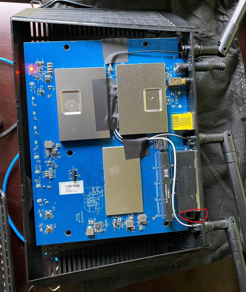

        I have come to a theory that the factory reset button doesn't actually reset the router.  I have kept it depressed for 7 seconds, 10 seconds, over 1 minute and the flashing amber power LED never changes states.
        Now it's about silly pride.  The router was practically new when I bricked it.  I took off the cover to see if I there was anything obviously amiss.
        Anyone know if there is an alternate and/or physical way to force a factory reset?  I realize this is an inexpensive router, but I am not quite ready to recycle it, but close.  TIA!
