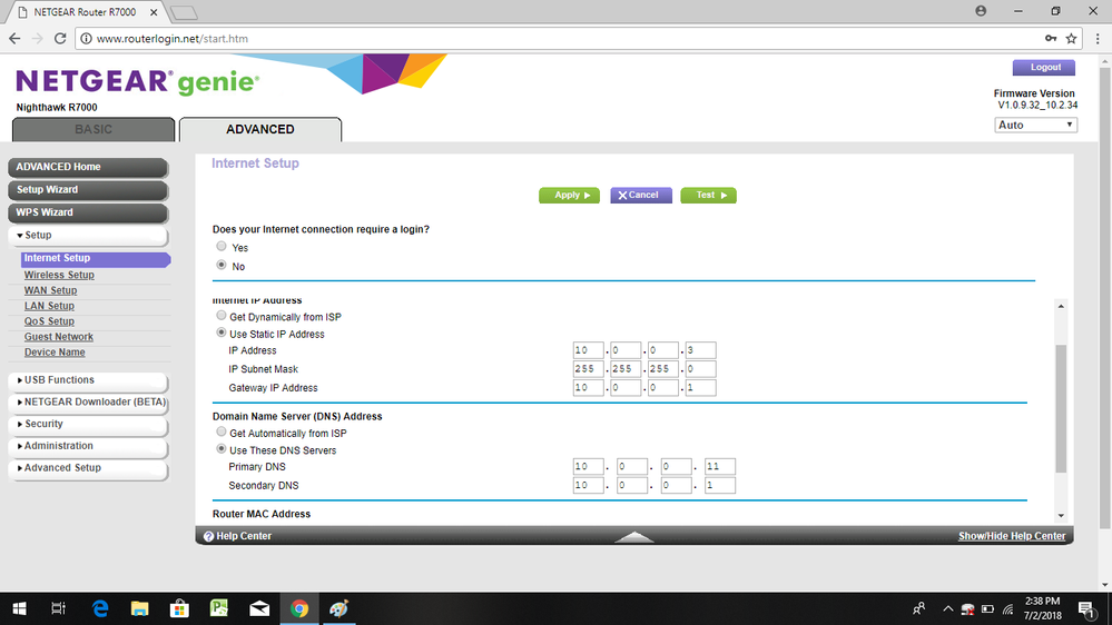

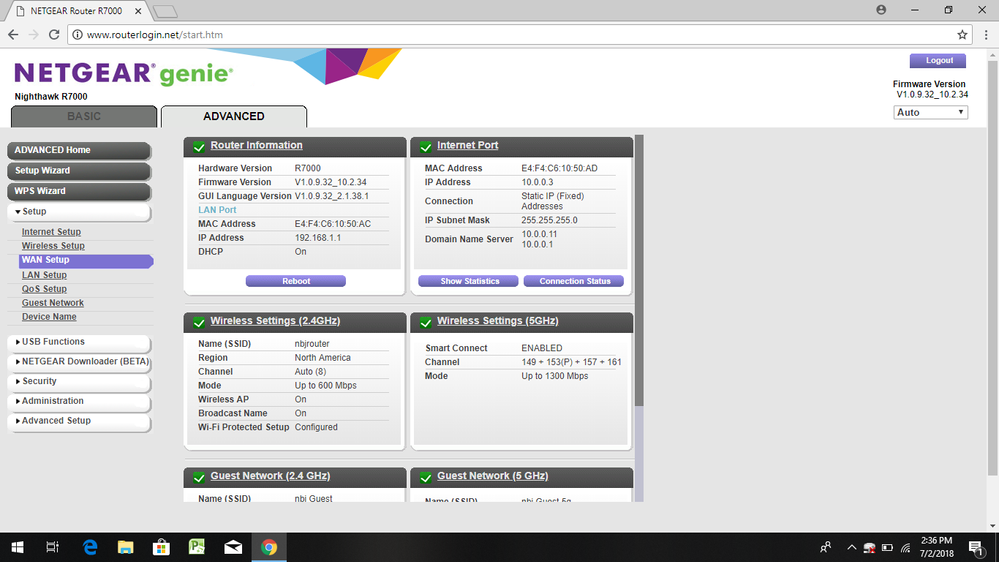

mitul
Jul 02, 2018Aspirant
the firmware is uptodate, 1.0.9.32_10.2.34
Before I had it set up in AP mode, which was was letting my server issue IP addresses and connect to network files but not letting wirelsess devices connect to the net.
Now I have it set up as Router, but it issues its own ip address and will let me connect to net but not my local network b/c it issues ip address starting with 192 while my server issues ip address starting with 10. Under wan set up i have told the router that the domain name server is my servers ip addess however it will not allow me to turn off DHCP (as soon as i turn this featur off, it will lose all connections and will not let any device connet to the router, I have to do factory reset and start all over.) and DHCP will not allow me to issue address that match my server ip address.

- mitulJul 02, 2018Aspirant
I did not mark this thread as resolved. I believe netgear rep did.
See below for how i have it set up right now to allow all devices to connect to the internet. If i were to change from router mode (which is what it is right now) to AP mode, it will issue ip address in line with my windows server (my primary, and would perefer to be only source of ip address). Then those devices will be able to access files and printers on my network, but will not be able to access internet.
If i keep it in the router mode, the netgear box wants to issue its own set of ip address which are not in line with my network and will not let them access network pritners and files but will let them access the web. If I uncheck use router as DHCP server then any device other then the laptop i am using to connect to netgear genie will lose all connections to the web, and if i were to renew ip address on the laptop and the laptop losses connection to the genie and web and i end up having to factory reset to get it back up.
