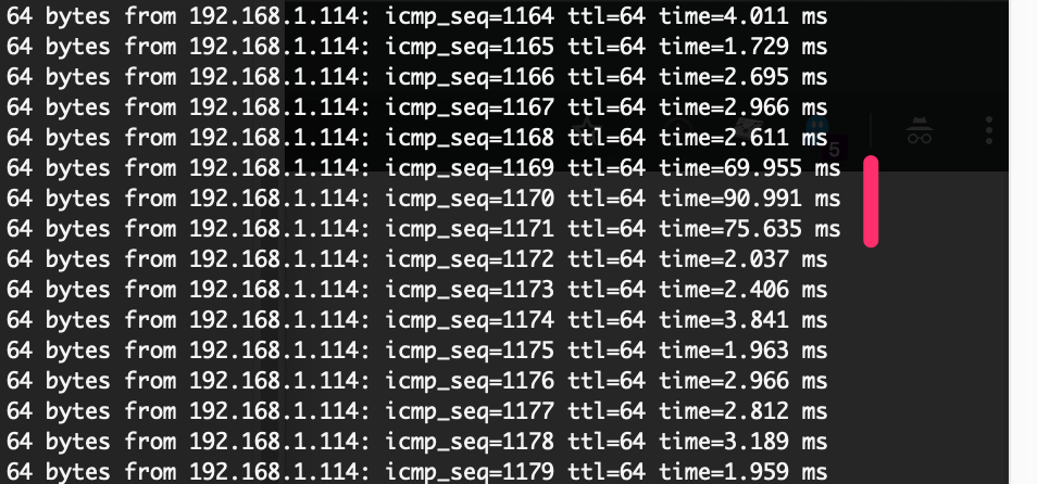

My initial feedback: the periodic wireless drop issue seems vastly improved, but not entirely gone:
- Used to be ~10 seconds of drop every ~10 minutes (with fw .58 / .60)
- Now with fw .62 I observe ~3 seconds of higher pings (100-200ms) every 3 minutes (quite consistently). No full drop. 🤷🏻‍♂️local ping test on firmware 1.0.2.62
Test method used: pinging a wired machine on the local network while laptop is connected via 5 GHz.
