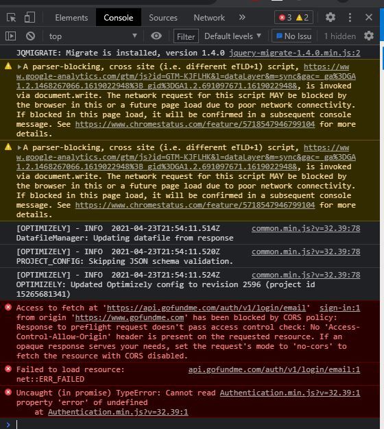

Information from the Chrome Console
- dschildApr 23, 2021Guide
Tried providing a picture of the Chrome console, but here is the error text. I reported this issue to GFM and am thinking they decided to block my IP.
sign-in:1 Access to fetch at 'https://api.gofundme.com/auth/v1/login/email' from origin 'https://www.gofundme.com' has been blocked by CORS policy: Response to preflight request doesn't pass access control check: No 'Access-Control-Allow-Origin' header is present on the requested resource. If an opaque response serves your needs, set the request's mode to 'no-cors' to fetch the resource with CORS disabled.
api.gofundme.com/auth/v1/login/email:1 Failed to load resource: net::ERR_FAILED
Authentication.min.js?v=32.39:1 Uncaught (in promise) TypeError: Cannot read property 'error' of undefined
at Authentication.min.js?v=32.39:1
When I logon via cellular network I get this error, but I am allowed access:
GET https://www.gofundme.com/assets/svg/fa-icons.svg net::ERR_ABORTED 404
