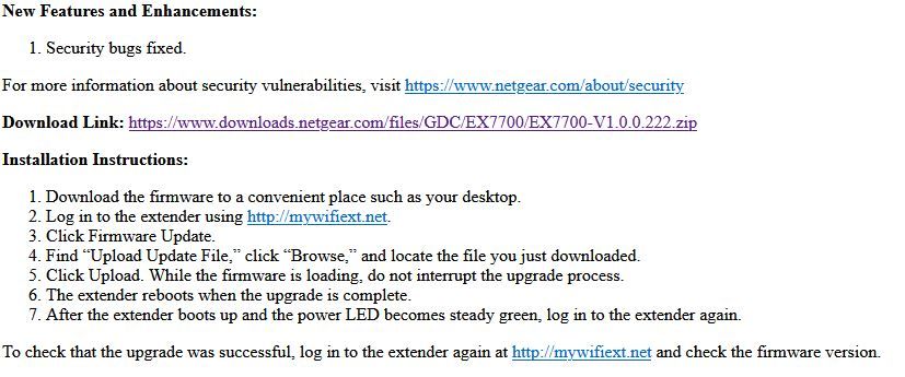

OK thanks for that. Then how do I update the Firmware as it doesn't like the Netgear_Ext. address?

Are you sure that's your SSID and not someone elses?
Have you tried logging into the extender to see what firmware its on? You might be on the latest as the email updates are just sent to everyone with that registered device.
https://kb.netgear.com/000061572/How-do-I-manually-update-the-firmware-on-my-NETGEAR-WiFi-Extender
- PW05Jan 25, 2022Aspirant
when I go to bullet 2 of the installation instructions of New Features and Enhancements I receive a message saying unable to connect?, I have tried again and waited as suggested but still the same result
