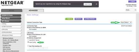

NOTE: IF DNS issues are seen with this version of FW, please enable IPv6 protocols on the router. ...
