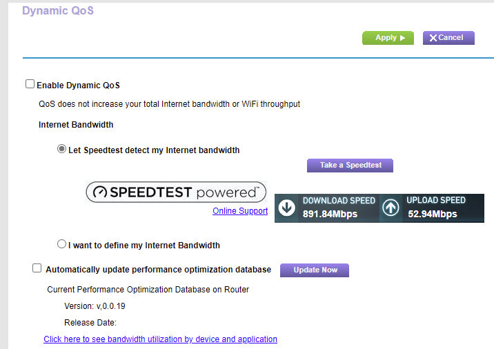

OK, just put my R79860P with v.88 loaded and factory reset and setup from scratch online connected to a CAX80 in modem mode. Traffic Meter enabled. Armor, Circle and QoS disabled.
Wired speeds are good:
Also onboard Speed Test app seems to be fixed working now:
Will also monitor for DNS issues. I'm using default ISP detected DNS addresses.
