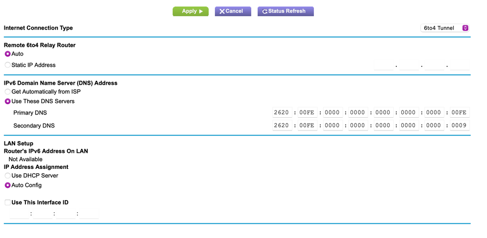

Can you post a screen capure of this on the IPv6 page of the router please?
Oct 20, 2022Guru - Experienced User
This is the only setting that should be set if your going to use IPv6 for the DNS work around:
- cybotOct 20, 2022Luminary
I am using the IPv6 page not as a workaround but to access a ipv6 tunnel to give me IPv6 access. my stupid ISP only gives ipv6 access to it's business customers, and even then only for an additional fee. so to access ipv6 content i need a IPv6 tunnel from Hurricane electric
- FURRYe38Oct 22, 2022Guru - Experienced User
This is my R7960P loaded with v.94 and how I had IPv6 6to4 Auto and Custom DNS configured:
I believe I did this on Mac with Safari browser
- SimonB1979Oct 22, 2022Star
I had to select DHCP server instead of Auto Config at the bottom and IPV6 6to4 tunnel started working on my R8000p! 👍🏻
