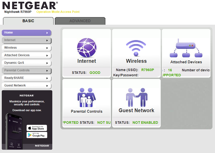

- SkyHopperNov 06, 2022Aspirant
After I upgraded my Nighthawk X6S (R7900P) which is in AP mode to Firmware 1.4.4.94, I'm not able to access the Web UI. The network 172.16.x.x/22 network of which the AP is given a DHCP address of 172.16.x.5. It appears to reset the TCP connection when using any of the standard browsers ie Safari, Chrome, and Firefox. You can ping 172.16.x.5. But you can't access the R7900P via IP address via browser.
I have reset the router to factory settings. It works in router mode. But the second you set to AP mode, you can't login to the Web UI. It appears to work. WiFi works fine in AP mode. You just can't log into the web console to manage it.
Please fix.
