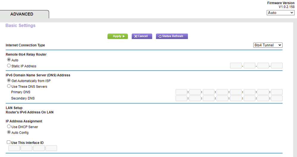

Try enabling IPv6 on the router? Set someting up for automatic for IPv6...
- FURRYe38May 06, 2022Guru - Experienced User
So I put my slightly used recently arrived R8500 online the other day. I am noticing DNS issues. So I enabled IPv6 using Auto Detect options and applied. Not seeing any more DNS issue however going to run this a bit longer. Other wise, FW seems ok.

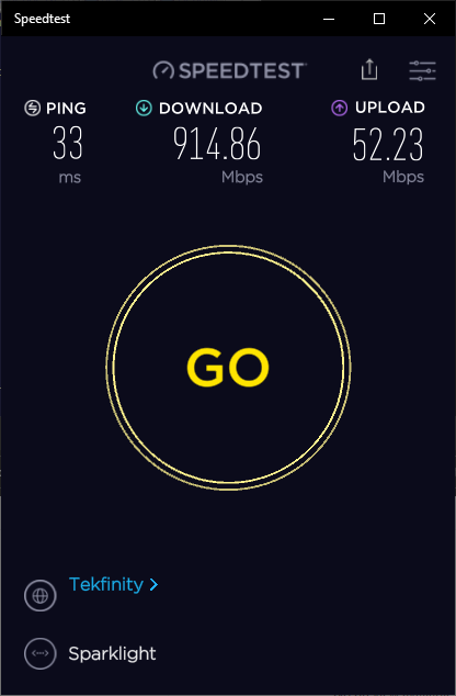

Im using v.158 on my 8500. I don't see any slow downs if IPv6 is enabled:
Wired speed with IPv6 enabled:
