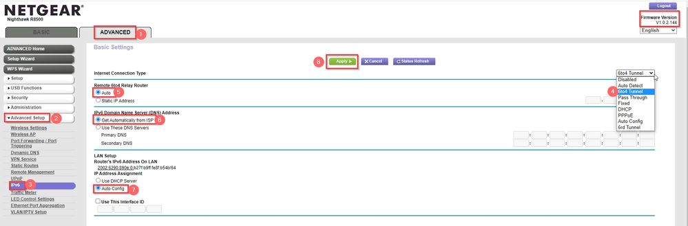

Enable IPv6 Auto if you con...

I'm still using 1.0.2.144 along with IPV6 setting and it's pretty Staable. that DNS issue is killing a lot hence seeking the latest Firmware 1.0.2.160 answers if that resolving the issue completely or we should stay on .144

The 8500 has done into EoL state. So no new FW would be forth coming.
I've not seen any issues with DNS if users set IPv6 to AUTO or configure a IPv6 DNS configuration on the router, i.e. Hurricane Electric IPv6 services.
