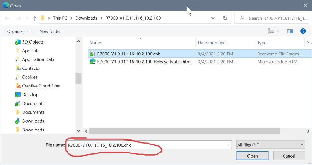

- ng_huskerMar 04, 2021Guide
Not what happened here. No user error, zero. Updated firmware many times over the last 7 years--ON THIS ROUTER. Just used the update UI. I know how to update firmware. And even to make sure, I had retried the download/install sequence several times on the first date I tried the patch.
Michaelkenward fair enough, no way of knowing what process users follow and I did say clicked 'ok' at one point. My bad on that confusing comment.
But it doesn't change what ACTUALLY happened. It's definitely not user error, the standard router UI-based upload process was used--same as has been used probably 30 to 40 times before in the years I've had this router.Screens showing the simple update sequence:
Tried downloading the bits, then installing as above, 3x on the January attempt. Same error all 3x, no way this is user error with my background and such a simple UI-based operation. And I've seen this report from other users online.
