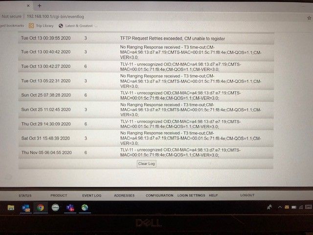

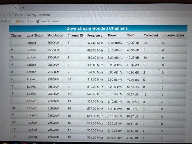

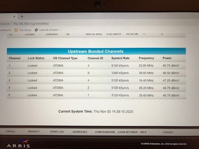

If you log into the modem's connections page (usually 192.168.100.1), it should show you the cable connections page and logs.
You can post them here and I can take a look at them to see if there's issues.

your signals/lines look pretty decent.
So it could be a router issue but its still worth making sure its not the modem or line.
