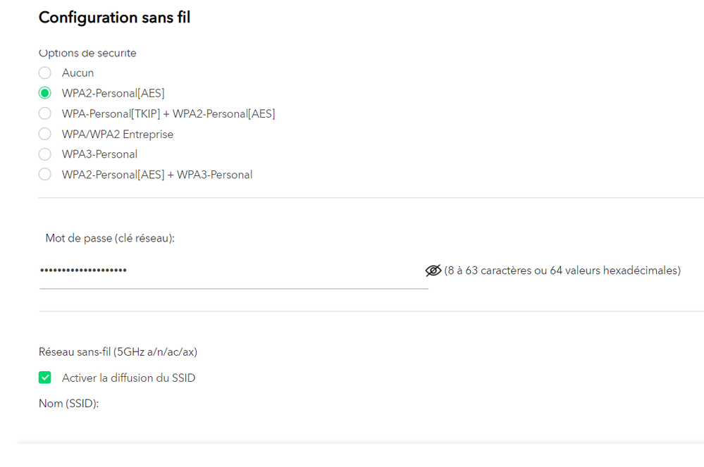

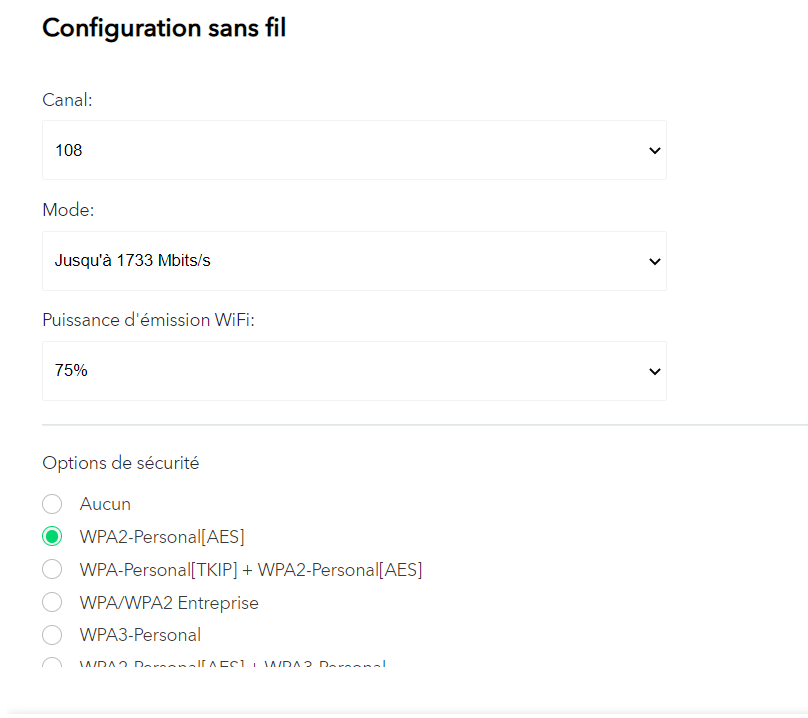

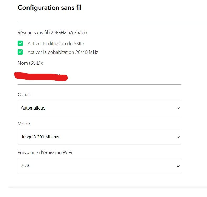

- I am experienced in radio module ... and I have correctly configured the frequency bands, channels on the web interface of the router, in 5GHZ I use a channel that is not overloaded.
- all the way down the wifi configuration.
- Problem 1 that I have, and that the product is not stable, despite being able to reach the maximum speed, it often happens that in vio meting it blocks, it lags.
- Problem 2 that I have, and that I find myself forced to restart the router for one reason or another, the 5GHz network takes more than 15 minutes before being available, while the 2.4GHZ is available more quickly .

Has a factory reset on the RAX40 router been performed and setup from scratch?
What CAT# cable are you using in between the host router and the RAX? CAT6 is recommended.
Does the RAX have good ventilation where it's placed?
You can post here if you want to for French support:
