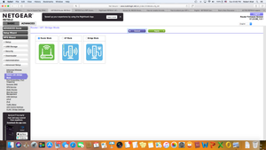

Nighthawk R6700V2 Router Firmware V1.2.0.88_1.0.1 The knowledge base article refers to the screen captured in the attached as having a Repeating Mode 7. Select Advanced Setup > Router/AP/Bri...

Apparently the screen capture I upload got removed. Bottom line is that it includes Router Mode, AP Mode, and Bridge Mode... but no Repeater Mode.
