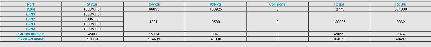

In the router GUI, under Advanced -> Advanced Home Internet Port, there is an button called Show Statistics. Under the Status column you should see your port connections. The connected input port from your modem and output port to your computer should show 1000M/Full connections. Do they?
Have you tested the various router output ports? Do all four of them perform the same?
- YasshakJan 02, 2023Aspirant
Yes, other than Lan 2 which is plugged into my tv everything is 1000M/Full. For the second question the answer is no, there's a bit of a performance gap in LAN1 and the rest of the LAN(S) from my testing at roughly 40 avg increase I tested each with the same ethernet cable 5 times.

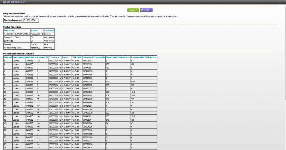

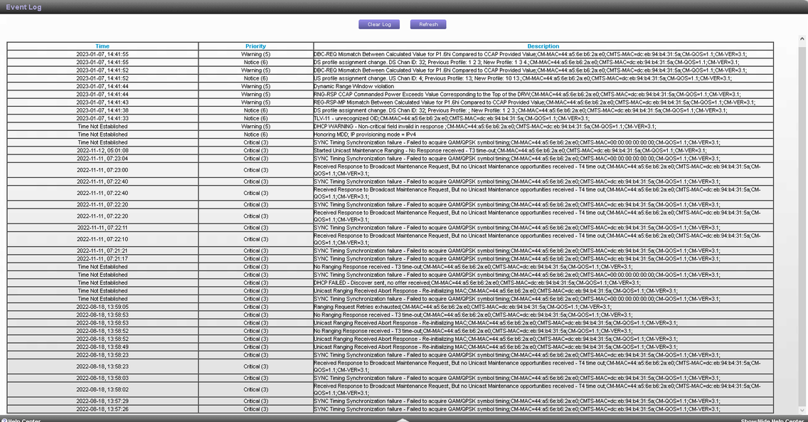

Have you logged in to your modem and looked at the signal power levels on the cable connection and the event log?
https://kb.netgear.com/24311/Power-level-guidelines-for-a-NETGEAR-cable-modem-router
- YasshakJan 07, 2023Aspirant
No I have not, I just did right now. Would you like the results of it? In the event log I have a ton of things that say critical but they are from a couple of months ago. I don't know what I am looking at on cable connection part though.
- KitsapJan 07, 2023Master
Yes, please. Copy the results to a word processing page. You will have to narrow the margins and reduce the font size so they are readable. Comcast is doing work in my area and I am keeping track of the results. See attached as an example.
