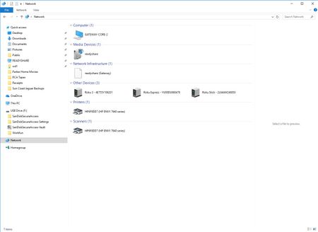

Nighthawk R7000 AC1900 Only allowing certain machines to see Readyshare
Having a crazy problem with my Nighthawk R7000 AC1900 Router. It is on a Uninterruptable Power Supply, but we have had some power interruptions in recent days. Everything was working fine. I upgrade...
- Aug 30, 2017
Thanks for reply. I figured it out. When the firmware was upgraded it set the Workgroup back to default name Workgroup. When I restored the correct name the problem went away.

This could be the reason why you are unable to access it due to SMB1 is disabled.
