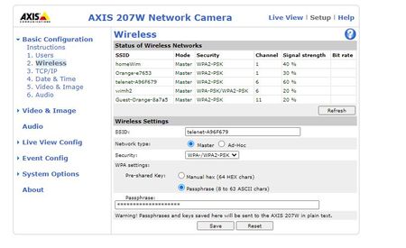

Hi all, Following problem : AXIS 207W Network Camera & Netgear Nighthawk R7000, The Axis doesnt see my netgear network. He sees the neighbours network, sometimes my other router (weak signal) ...

The somewhat aged 207W should recognize and be able to connect to the R7000 on the 2.4 GHz band (Wireless interface AXIS 207W/207MW is IEEE 802.11g/b).
