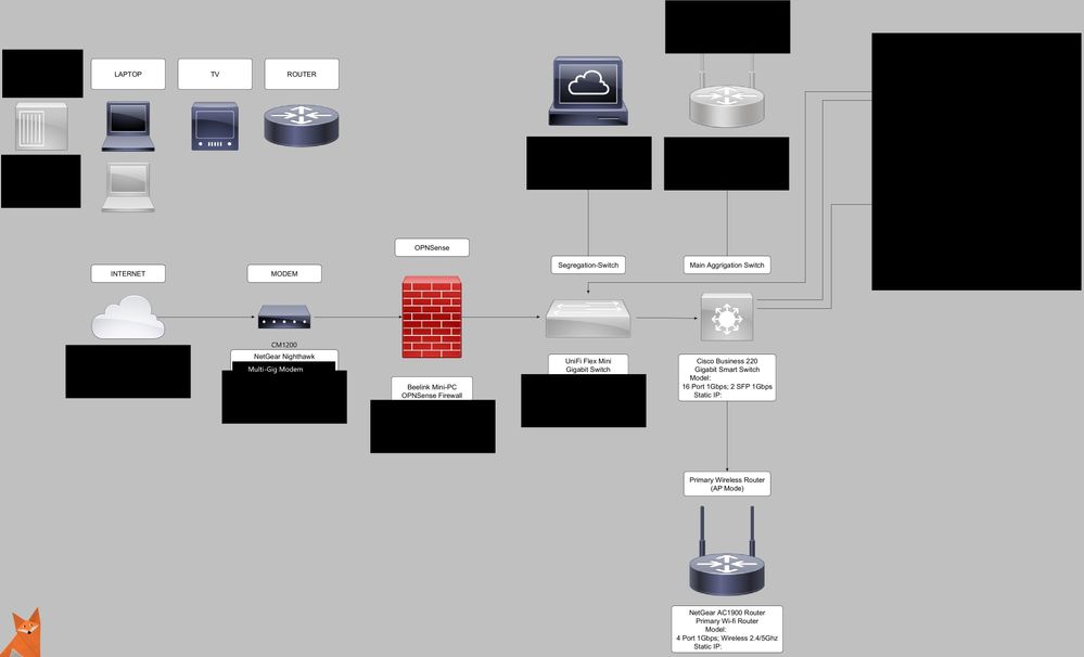

Newest versionCustom Router: Beelink with OPNSense
I have attached my topology, a side note, I took this completely off my network, LAN'ed into it, Factory Reset, and it automatically boots into Off after the setup, tried Router mode, AP mode (On network, receiving DHCP from OPNSense, static IP'd in OPNSense table, and R7000), left all settings default that I could, also setup and changed SSID/Password many times, no duplicate SSIDs, networks, or IPs.
