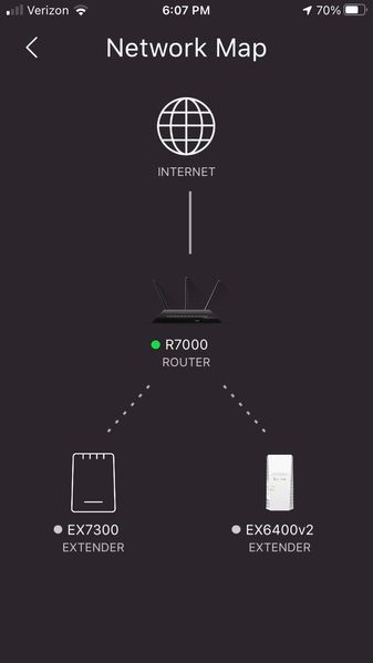

Nighthawk R7000, V1.0.9.88_10.2.88, wifi drops
There are numerous posts on these issues. My R7000 has begun developing more frequent internet outages over the last 6 months. Now the frequency is about every 10 days. The topology picture fo...

Hmmm.... no pictures are showing up. I apologize, but I think the content of the post is evident. I should mention that whereas the smart power switch has 2 "smart sockets", I intend to only use one switchable socket, intended for the R7000. I don't yet see a need to jokt the modem with power cycle hits until further indications. Of course, the smart power switch will be plugged into the UPS.
