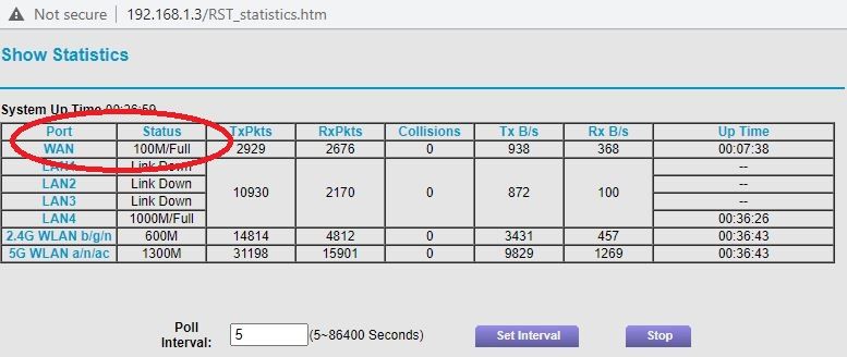

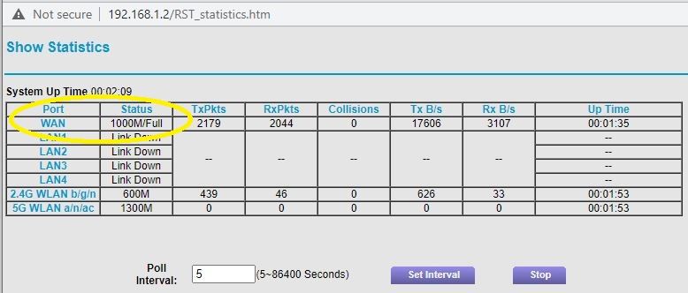

WAN link for AP#1 is at 1000M and anything that connects to that AP achieves ~240M download.  All good there.
Issue that I have is that WAN link for AP#2 is at 100M and anything that connects to that AP is capped at ~95M
So far I have restarted everything multiple times, checked (all pairs working fine) and replaced all patch cables, cleaned all RJ45 ports, reterminated the hard wiring and replaced RJ45 wall socket and factory reset and reconfigured AP#2.  No joy

    couple things to try.
    Grab the one with slower speeds. Move it and direct connect it to the linksys with a known good 6ft cable.
    Maybe you have a damaged ethenet connection on the router.
    I think the r7000 had an wan port mirror option in the debug menu. Try going to the routers ip address with debug.htm at the end.
    for example: 192.168.1.1/debug.htm
    I believe you can mirror the wan port to lan port 1. If the port was damaged,this might get it back to full speeds.
