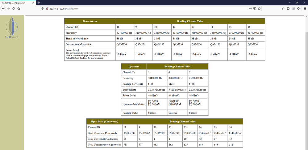

So the tech came out and checked the lines. There was a lot of noise in the lines and they replaced all the lines to the house and I have been problem free since. Lines were the problem. Thanks for your replys guys.

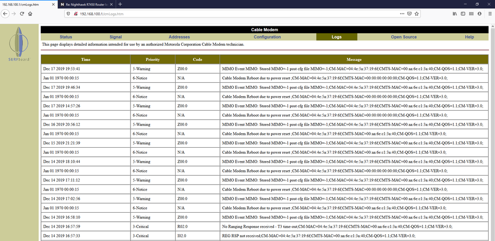

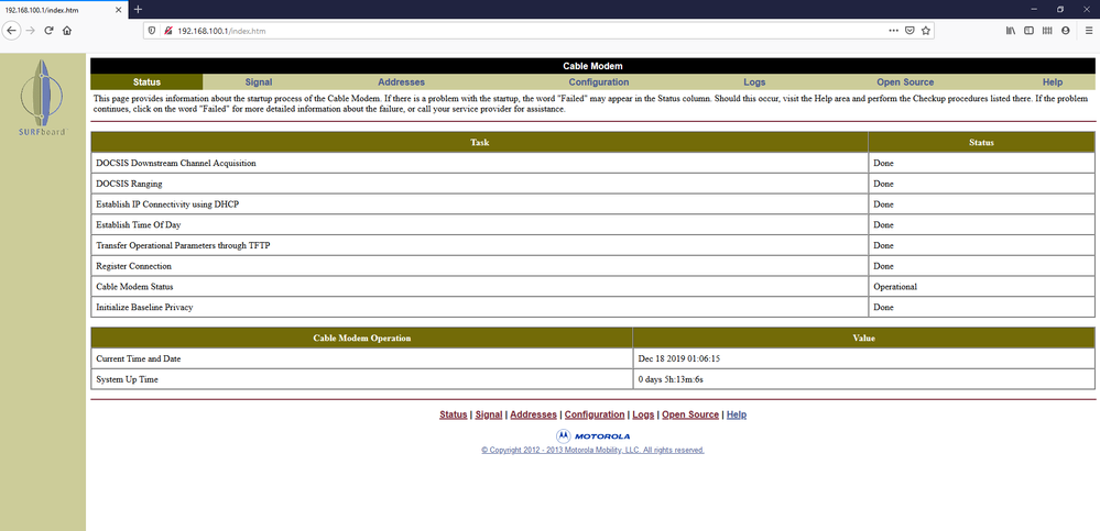

You can also log into your modem and get a screen snip of your modem connections page. Many times this shows a snap shot in time of your connection to the modem.

I have Factory reset both Router and Modem and the same problem keeps happening every couple of days. The Router doesnt detect any Internet connectivity (The second light from the left is amber instead of white). I believe I may have figured out an issue. It seems to happen whenever the Lease expires from the modem. I do not know much about that but the time frame is around the time it expires. When I physically Release it from the Web Page interface for the router That light turns Amber and hit renew it comes back after a few moments. Im thinking this may be the issue but im not an expert. Any suggestions are appreciated.
