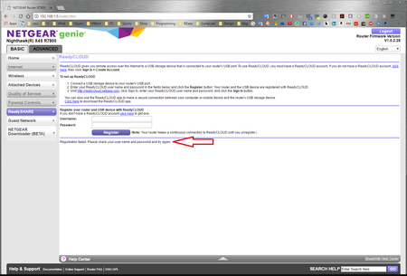

Nighthawk R7800 - Imposible regirter router in ReadyCloud
Model: Nighthawk X4S AC2600 (R7800) Firmware: V1.0.2.28 (Latest) I have created a new account from here, which gives me access to the MyNetgear account. Next step should be register to the Read...
- Jun 23, 2017
I've detected the problem.
As can be seen in the picture (but I didn't stated in the first post), the router was configured in AP MODE, which doesn't detect properly internet connection to connect succesfully to ReadyCloud (having an active connection obviously).
Configuring the router in standard or router mode, the ReadyCloud registering process has no problem at all.
I think this should be fixed, to be able to register the router also in AP MODE.

mondenath
May 11, 2017Prodigy
it usally dont login . If you are having issues check the dns and network. It should work.
did you first able to login to readycloud account.
