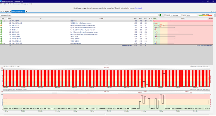

I just had the ISP here and it appears there's two issues at once. Upon investigating, the coax line to the service was above 12ghz (or whatever the increment is) from channel 76 and up which was causing some increased connectivity issues. By implementing a 10gb splitter, the signal is now in the 9's and not being overloaded. He stated he believes the router was pulling too much power from the ISP pod in my apartment complex since it tries to manage so much traffic. That's one part of the issue.
After using pingplotter some more, I'm getting about 50% packet loss on the router itself. Every half second, there is complete packet loss and then no packet loss. The latency issues connecting to that earlier server were mitigated slightly, but I'm still having latency issues. To resolve this, I am going to go ahead and factory reset the router, as well as update the firmware over ethernet. Then from there, I'm going to start setting up everything manually.
It sucks that there have been so many issues. I want to love this router, but with all the pain it's causing I'm starting to despise it. Unfortunate, but I'm frustrated.
I'll provide an update as soon as I get some substantial results. I will attach some screenshots as reference to my earlier paragraph to show what I'm getting on the router with packet loss.
- FURRYe38Dec 15, 2022Guru - Experienced User
What results do you see if you disconnect the router from the ISP modem? Just let it sit there and ping it's IP address.
Also try with the wifi disabled on the router as well...
