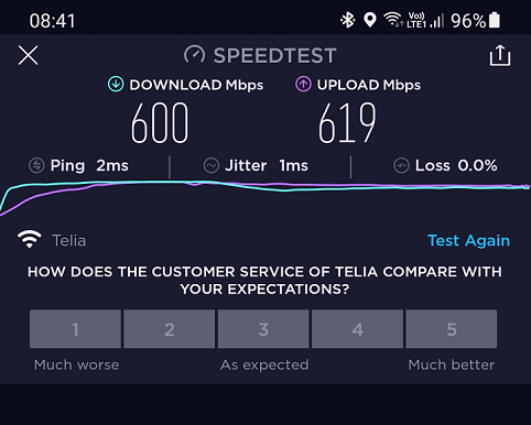

- PauLitaApr 15, 2021Luminary
I have nothing to complain: :smileyvery-happy:
R9000 -> Sansung S20Ultra
