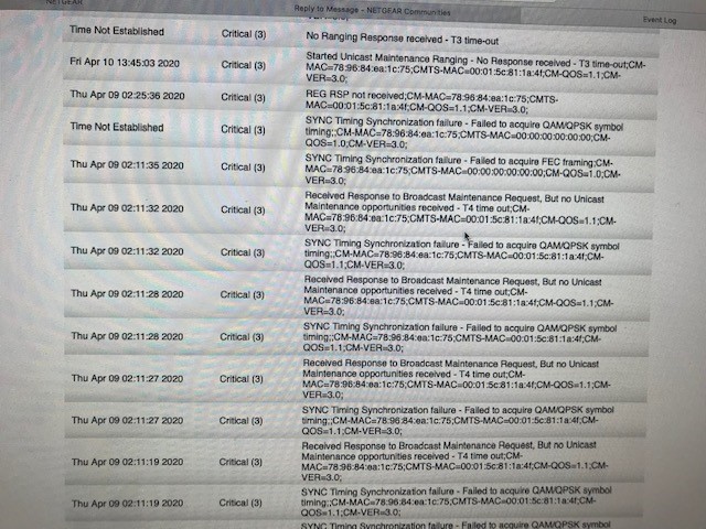

I can see there are some errors on the log file. Let me know if this helps in finding the issue.
- plemansApr 14, 2020Guru - Experienced User
the t3, t4 errors tend to be signal issue problems. Your downstream signal looks fine but I couldn't see anything about the upstream (or i missed it).
It'd be worth it to have the isp check the line. If you've got any splitters in the line, remove them.
- rmisencikApr 14, 2020Guide
No spliters on the line. I have a 30 day return policy on a new modem and with it being 5-6 years old, it could be the problem. Let me try that today and see if that improves the situation. If not they will need to have ISP check the line.
- rmisencikApr 15, 2020Guide
Status update. I think it was a mix of old modem and something wrong with the line. I didnt recall we had a boster put on the line several years ago, but the tech from Spectrum looked at each of the connections and cut off the current one to expose a fresh line and connector. He also bypassed the boster. After that we are running at over 100 down and around 10 up, which is very consistant. I dont want to try to go back and replace the new modem with the old on since we are running so good. Thanks for you help on this.
